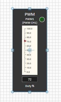

I starting up a project where I want to use PWM. If I open the examble from Wiki I am able to see the timing pulse with. In Fc10 I only see a slider like potmeter and can´t see the pulsewith in simulation, is this normal? please.
Br Jorgen

Hi Jorgen.
Yes, that is normal as that is the default.
If you want to have the lower image instead of the upper image then within the PWM properties, under Simulation, change Representation from Analogue to Digital.
I must admit I do like the digital.
But I'm a bit biased as I designed the digital version lol.

Well Well Martin one more good thing in FC. I did not know it was possible. Yes I also prefer the old view. :lol:
Test it tomorrow. Thank you for fast reply and help.

I have edited the Wiki to explain how to change from the slider to the digital version.
I'm glad you mentioned it, thank you.

It work´s just perform a test, nice to have Both options. ;)
