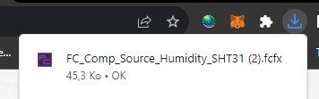

When I'm trying to download the VL53L0X , I'm getting this below and the file is now downloaded
I tried with another component and it work well
thanks for a prompt reply

Thanks for letting us know. This should get fixed soon.
In the meantime, you should be able to download the file by right-clicking and selecting "save link as...". This will currently only work if you visit the wiki in a browser rather than from within Flowcode itself.

Thx, it work's

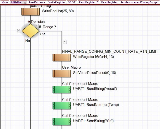

I was looking the code of the VL53L0X sensor.
Could you explain me why Macro "SetVcselPulsePeriod" is never used during initialize.
Range value is always 0 thx

As far as I can tell, this relates to a "long range / short range" option which is currently unimplemented in the component. If this is a feature you require then please let us know and we can look at implementing it.

I have not got a VL53L0X sensor to test with, but the long range / short range" option has now been implemented.
Can you please let me know how you get on with the change.
If you are happy with the change, the component modification will be pushed onto the update system next week.
