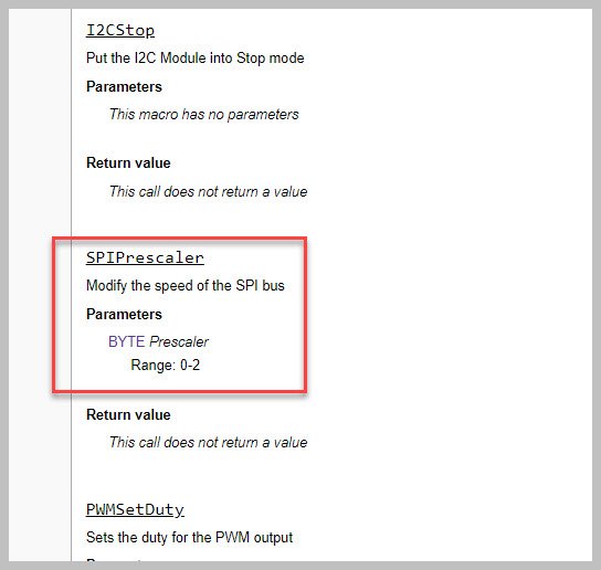

Hi Team.
From the UNO SCADA help file the values for the SPI prescaler range from 0 -2 (0,1,2)
Can you guys please help me if the UNO Clock frequency is 16MHZ what will the SPI Clock then be if we use
0, = ?
1, = ?
2, = ?
prescaler
Thanks for helping out

The documents aren't very clear?
I'd guess the values correspond to prescaler of 4, 16, and 64 (ie clock of 16Mhz (FOsc?) / prescale) - the firmware calls SetPrescaler in the CAL SPI. (Docs don't specify here either)
Edit - however experimenting in v8 (see below) - calling SetPrescaler with (2,4,8 etc) gives the expected results (at least in software mode).
