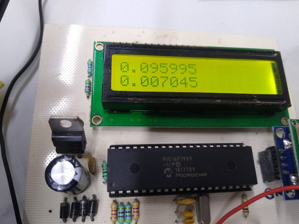

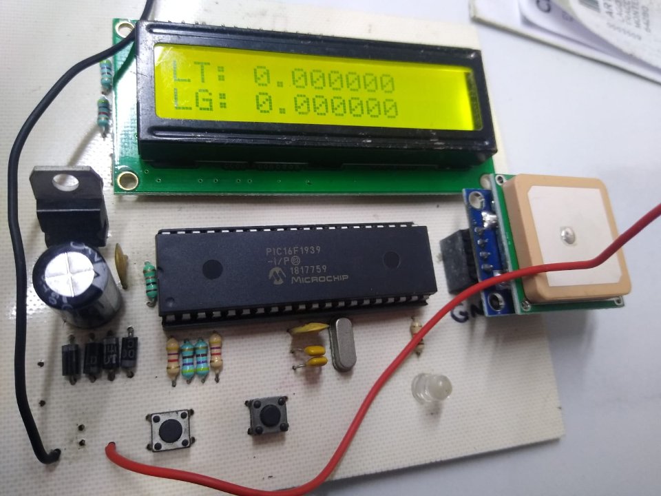

Hello, I would appreciate some help,
I am migrating programs that I have made from previous versions of flowcode, V5, V6, V7 to the new version 10, at this moment I am with a program that uses the GPS component, to read Latitude and Longitude; but I can't read the location, it sends me 0.000000 and 0.000000, I use the example and another program that I believe simplifies the example using new options offered by Flowcode 10.
I send the flowcharts of 2 examples that do not work for me.
Enrique

After 3 hours one of the programs (TEST1939v10) could be connected, but with readings that constantly varied. . .

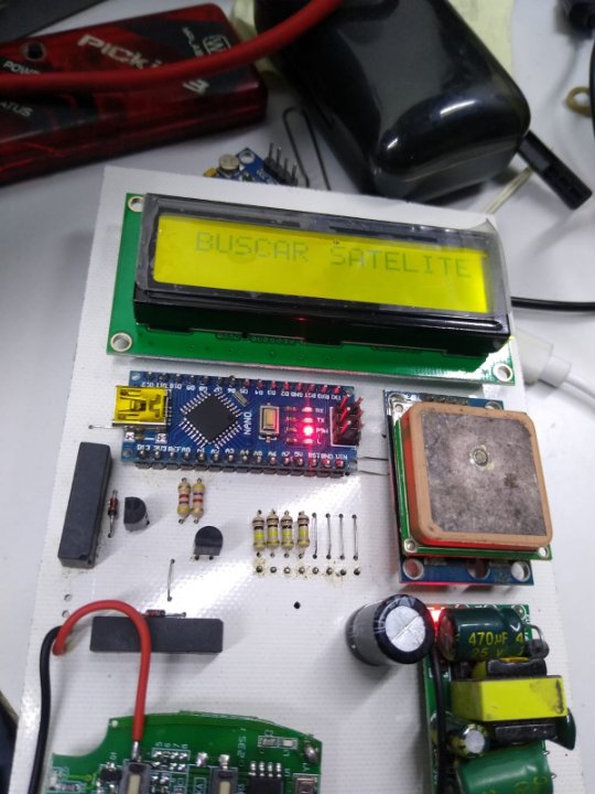

Yesterday, the circuit was connected and in 8 hours no satellite was connected.

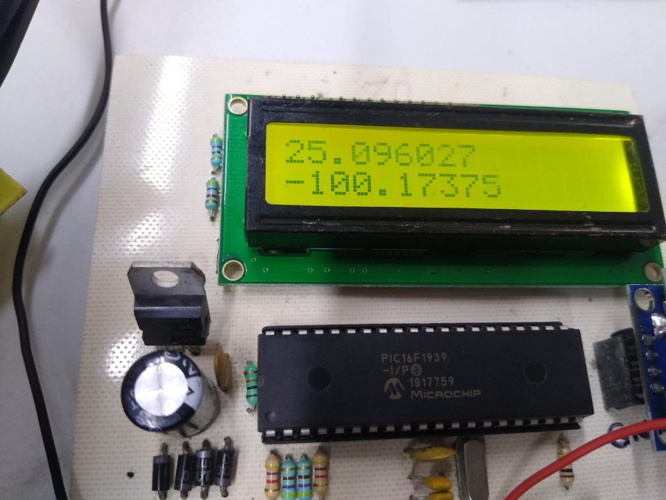

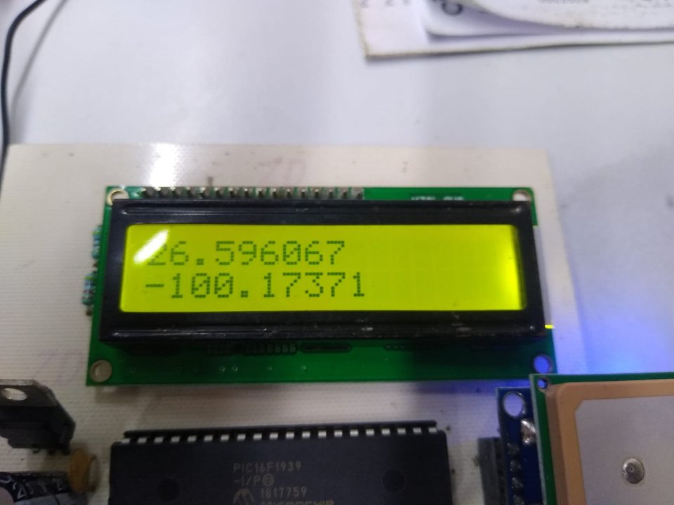

The longitude is correct, the Latitude varies too much

The latitude continues to vary a lot, the longitude remains constant and correct, on average for every 10 readings, it sends a correct latitude
