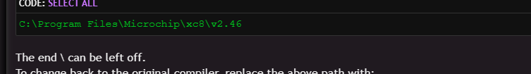

Select File > Global Settings… > Locations tab
Under Override toolchain locations, enter the path where the Bin folder is located, e.g.
C:\Program Files\Microchip\xc8\v2.50
The end \ can be left off.
To change back to the original compiler, replace the above path with:
C:\Program Files (x86)\Flowcode\Common\Compilers\picv2\
