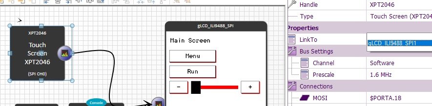

In the properties of the touch component you didn't have the GLCD linked. this would stop the simulation touches from working.
With it linked it's now simulating correctly.

hi BenR,
Thanks for pointing it out to me. (It's working now). I was looking for it, but didn't saw it.

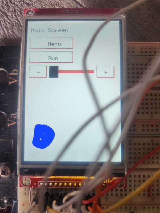

>> I enable Queue fast Pixel (yes) as it allows the display to go faster. But he displays is not moving Faster anymore after I updated the library not too long ago.
>>From the Original example "DisplayManagerDemo" its Flip XY is Yes.
This is how I would like my display to work Flip X yes, Flip Y no.
However, on the other hand, the physical touch on the display remains at a fixed position on the screen. when it has been touched "BUT WORKING"
I tried playing with the Physical Orientation (0-3), I increment and decrement the X, .Ycrood. But it remains the same.
I thought once the touch is enabled, anywhere on the screen will be available to touch. Its only Works where the blue area is)
I am not sure what else to do at the moment. (I need some suggestions on how to get it to work).?
I attached an image of it.
ryan.

It looks like the X/Y coordinates from the touchscreen need scaling up to correctly match the pixels on the display, maybe try multiplying the X/Y coordinates you get from the touchscreen component. Maybe * 3 or *4.

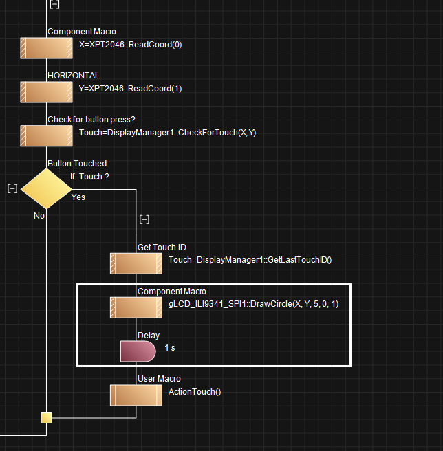

I have made an improvement to the XPT2046 resistive touch sensor.
Instead of returning either 0 or 1, it now returns the pressure value.
Therefore, within the decision branch, you can use for example.
All false touches will then be ignored.
The component will be pushed to the update system ASAP
If Touch >10All false touches will then be ignored.

Thanks, that is very ingenious of you.
After adding that little part to my program yesterday. It shows me that new touch screens (that never used) are defective.
Brilliant idea, YOU GUYS ARE DOING A GREAT JOB.
I will check it and let you know how it goes, when I have the time.
