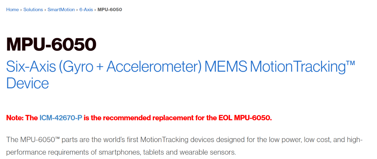

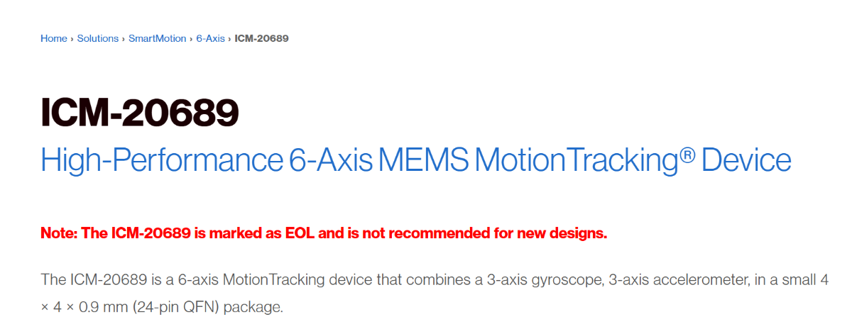

Posts: 1285
Has thanked: 245 times
Been thanked: 257 times
Re: MPU-6050 NOT WORK IN HARWARE
Hi to All
A question to Basl
Are you using the Senser on a small board?
for the new component, maybe I can help with testing.
There is a good overview of the TDK sensors. Which type and specifications
https://invensense.tdk.com/products/mot ... ng/6-axis/
but which is the current sensor ?
