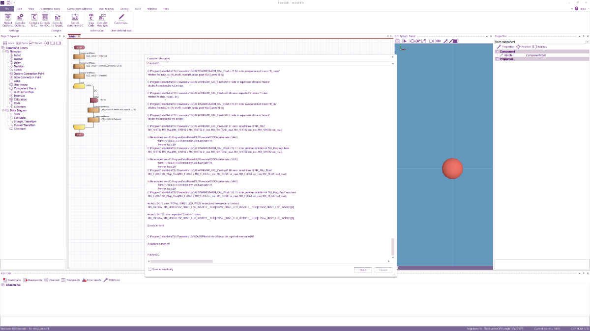

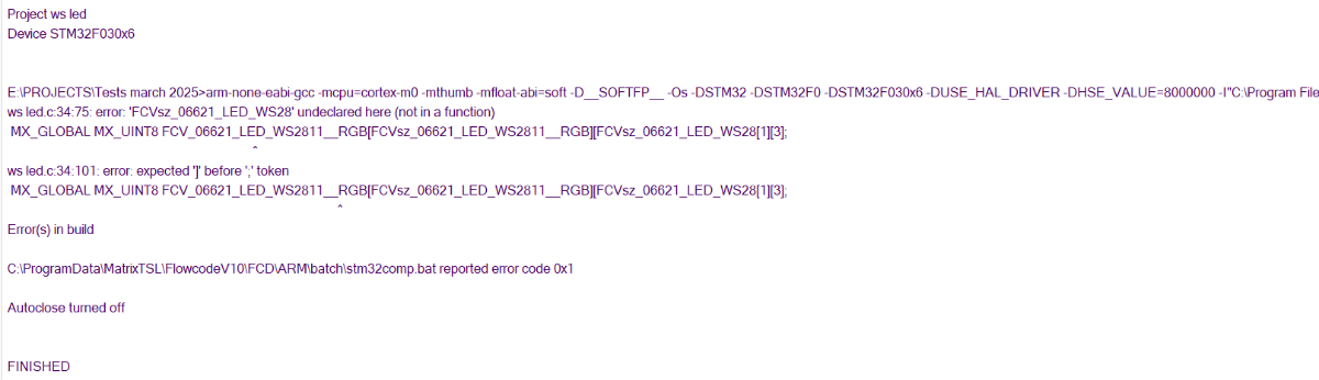

TheShadowOfTriumph
Posts: 24
Joined: Wed Feb 08, 2023 3:33 pm
Re: WS2811
Post by TheShadowOfTriumph »
Unfortunately, when changing the component version to 5, I see this.
