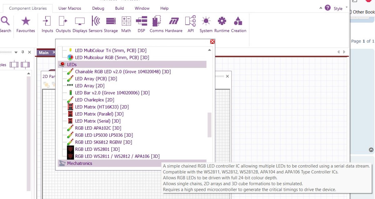

On mine it's under Components > Outputs > LEDs
Screenshot 2025-04-24 171820.jpg (126.97 KiB) Viewed 5242 times

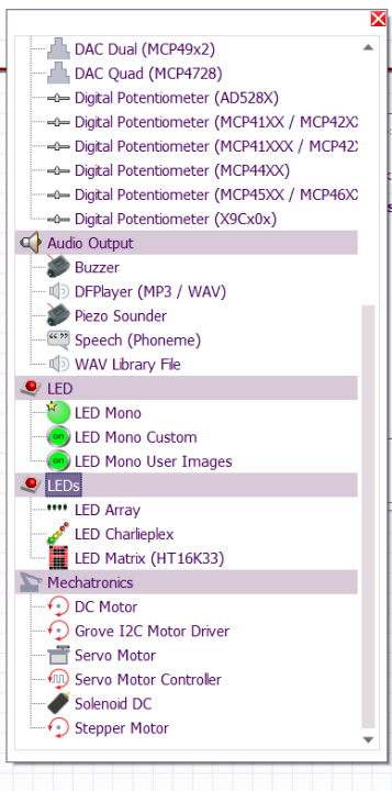

Thank´s for fast reply. That´s strange, in mine I only see:
Is there anywhere I can make a settings?
I have full update.
Skærmbillede 2025-04-24 183803.png (122.88 KiB) Viewed 5239 times

Under component libraries change "Show Components" to 2D and 3D
That should do it.

Wow, (lian, as far I remember :lol: ) I forgot that, now all component are there again.
Thank you.
