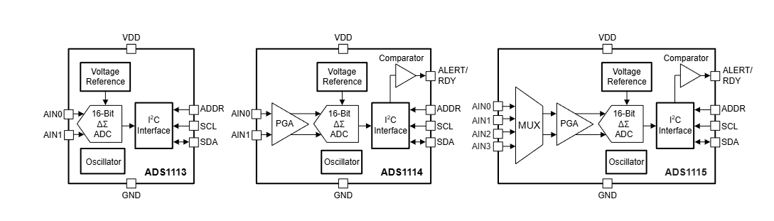

would it be possible to add an option to select four single-ended or two differential inputs ?
and also the PGA gain?
This is also an ADS111x
ADS1115: four single-ended or two differential inputs with comparator and PGA

Hi, great suggestion! Since the ADS1115 supports both modes, adding an option to select between four single-ended or two differential inputs, as well as configuring the PGA gain, would be very useful. Definitely worth considering!

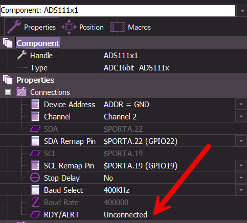

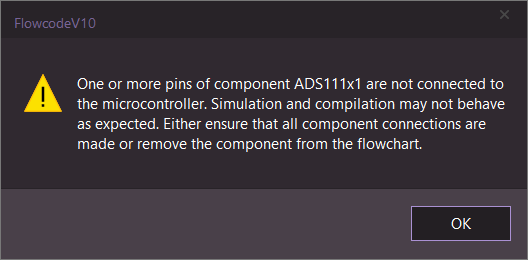

One more problem.
ADS1115 has an alert pin. If I use a board with I2C , the pin is not avaible.
In the propertis, I can select unconnect but then I get a warning and an error.
If i selsct an unused pin it's working
