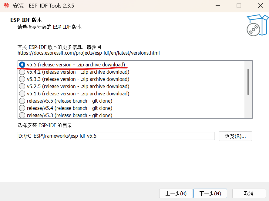

I have checked the Espressif website, the lastest ESP-IDF version is v5.5, is it help to upgrade to v5.5 from v5.3.1 ?
If it may works, how to upgrade, just download the ESP-IDF Windows Installer and directly install it?
Or better move to ESP-S3
Br Deqiang

I don`t know if the 5.5 is better? I switched to the ESP32 S3 model. I also don`t know how to upgrade to 5.5 because my 5.3 was installed via ESP toolchain, but the S model work fine by me.
Nice weekend
Br Jorgen
