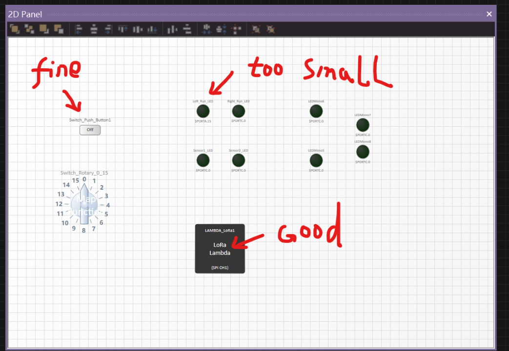

When using 2D panels, the default icons and fonts are inconsistent. Some are clear, some are fine, and some are too small to be easily recognized.
And the panel cannot be zoomed in or out as a whole, only by manually enlarging the small icons one by one, then the accompanying fonts become larger. Manual dragging can also cause icon deformation, affecting the aesthetic appearance of the interface.
I tried adjusting the font size in the global settings, but it didn't seem to be helpful here.
Can we add an overall panel zoom function (similar to a flowchart window, where holding down CTRL while scrolling the mouse can zoom in and out of the entire panel).
Alternatively, select a single or multiple icons that need to be enlarged and right-click to set the zoom ratio for them.
This is what I fell during use, and it is also possible that there are related functions but I am not sure. So please let me know how to do it.

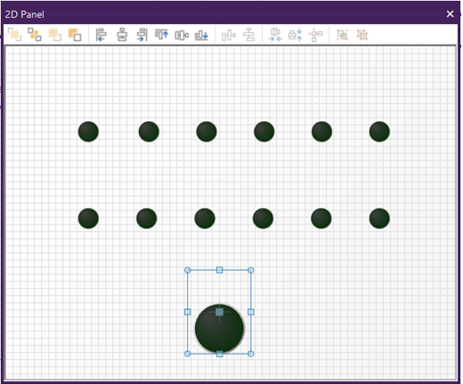

There is an option to make all selected components the same size as the first selected component.
First select the component that is the required size.

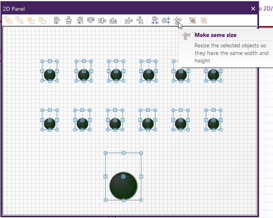

Hold the Ctrl key down and left click all the other components to want to resize.
Click the resize option on the top of the 2D panel.

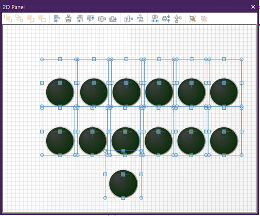

Now all the selected component will be the same size.
Resize 3.png (135.81 KiB) Viewed 5569 times
A tip. When a component is selected, select the Position tab, then select Yes for Lock aspect ratio.
You then then drag the corner to resize and the component will remain in shape.

Hello
Thank you very much for the clearly explain.
It works very well following your step.
Thanks again.
