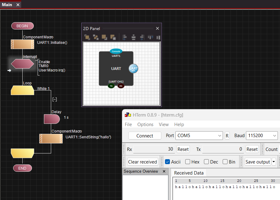

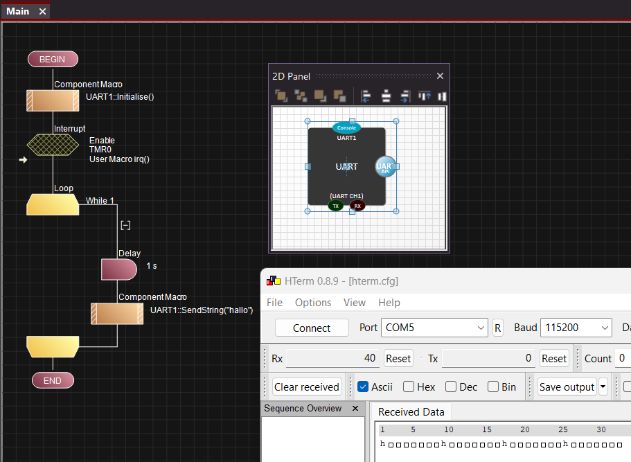

The connection to the pc is just working correctly if I add an IRQ in the program
And with 921600Bd it's received always wrong char even with IRQ.
Unfortunately, it doesn't work any better with the Atom S3 and Atom C3.
https://flowcode.co.uk/forums/viewtopic.php?t=3223
working nice
Not OK without IRQ

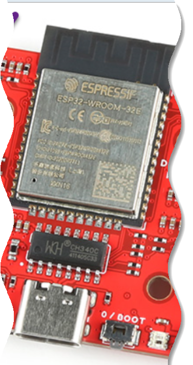

remark to 921600Bd:
With an ESP32 WROOM 32E and CH340C, the connection to the App Developer works perfectly with 92100Bd.
