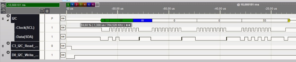

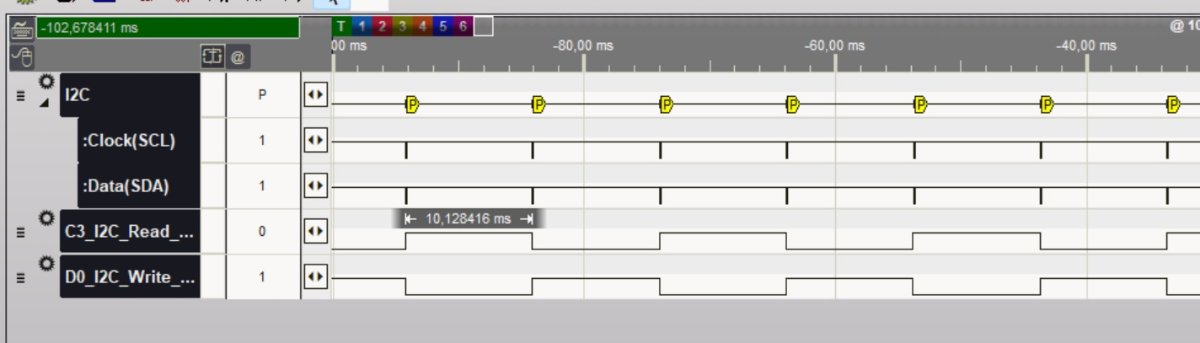

I tested the I2C component with a PIC16F1779 MCU and a 47C04 type EERAM.
Writing and reading work correctly, and the operations complete in about 100 µs.
However, the Component Macro continues to run for another 10 ms after a write or read operation.
What do you think could be causing this?
Thank you in advance for your help.
Regards,
Sasi

In the i2c properties there is a 'stop delay' setting - check this is set to no.

Post by Sasi »
Hi Martin,
Thank you very much for your help, it works perfectly after I turned off the Stop delay. :oops:
