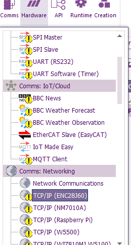

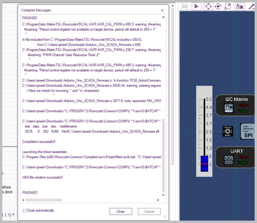

Hello I was about to upload the scada firmware to my arduino when I ran into this
I hope you can help me

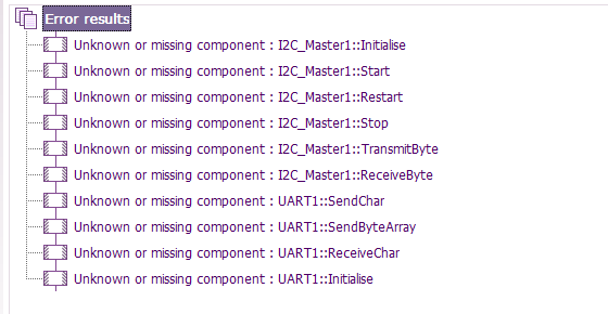

It looks like there are a few things missing in the file you have
I just last week programmed a UNO with this file you can try it make sure you select the Correct comport for your Board in the Properties
Included is the hex file you can program your UNO with Xloader and this hex file
Just compiled the file again ,make sure you are using the Firmware FC chart

The I2C Master and UART components require one of the comms packs.
You could instead use something like Xloader to load the pre-built .hex file onto your Arduino and then everything should work correctly without having to compile the code.

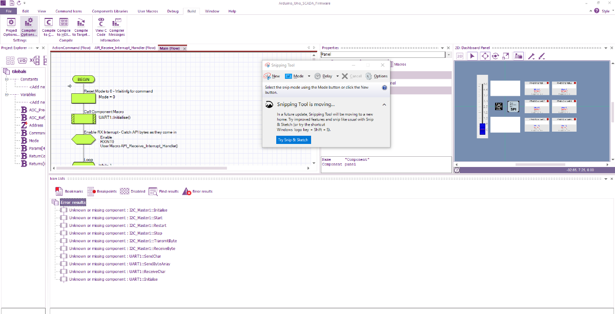

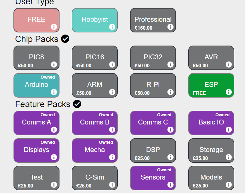

I purchased all the comm packs but it seems Like my flowcode hasn't been update, altough it shows me like it has been(in the license key)

You will need to re enter your username and password to refresh your license in Flowcode.
