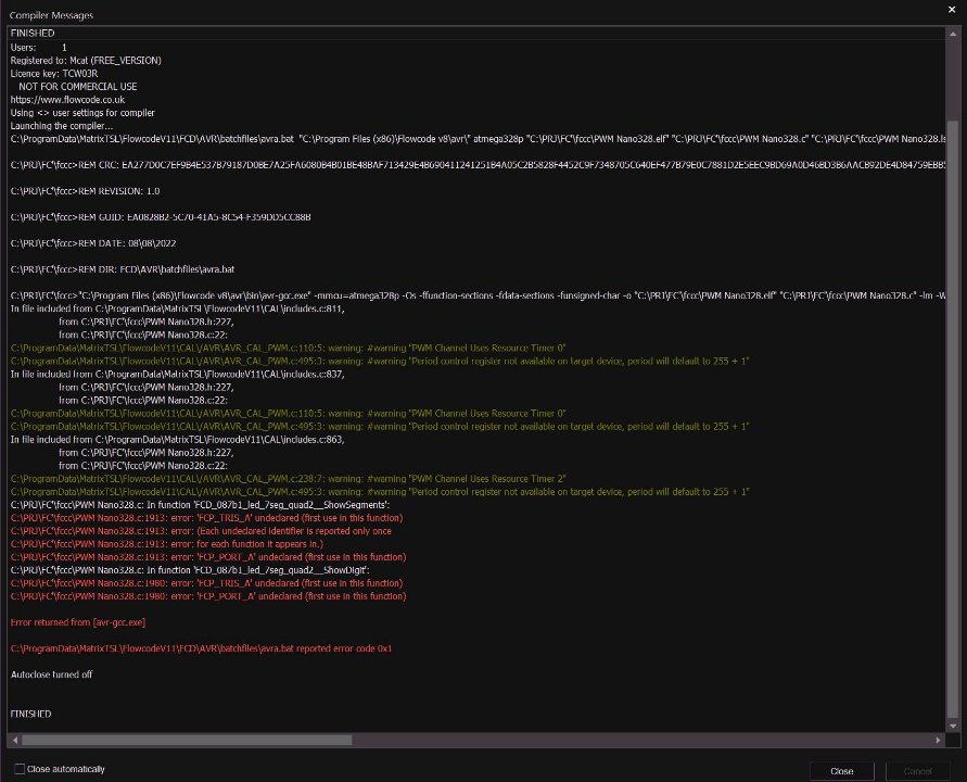

My project on ATMEGA328 uses three PWM channels. Everything works fine in the simulator, but it won't compile and gives errors like the ones in the picture. Please help.

Also, it was tricky to see what the error is from a screenshot. In future, it is much easier to solve problems if the output is available in text (e.g. by attaching the generated msg.txt file to a forum post).

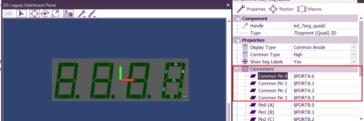

It looks like the specific error being generated it due to the 7 segment quad component pin connections, something there is referring to PortA which doesn't exist on the device you're using.
Maybe try going through the properties and checking there isn't a hidden pin thats referring to PortA.

From Ben's post, Please pay attention to this:
Within the properties change any pin that has Port A selected.
E.g. the top pin is connected to port A.0 which does not exist. As Ben stated port A does not exist, hence not able to compile.
Select the 7seg Quad component on the 2D Legacy panel then right click and select properties.
