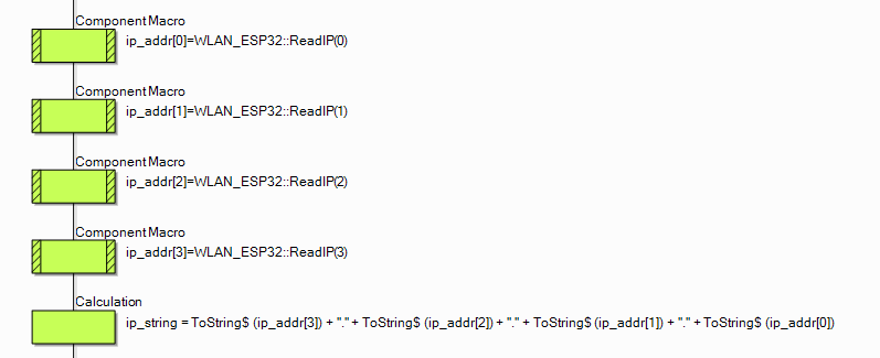

To connect the ESP Wlan to my own wlan is working with connectToSSID , but how to read IP Adress with the command ReadIP?
it give just a Byte return.
it would also be possible to add a set command (WriteIP) in the future?

I think you have to read a byte at a time incrementing the index value but don't really know
how you would know where to put the point you will end up something like this 19216801 for 192.168.0.1

Yes, you can use ReadIP to populate a byte array.
Then use string conversion to get into human-readable notation ...

Perfect! Thank you both. It's working this way.
