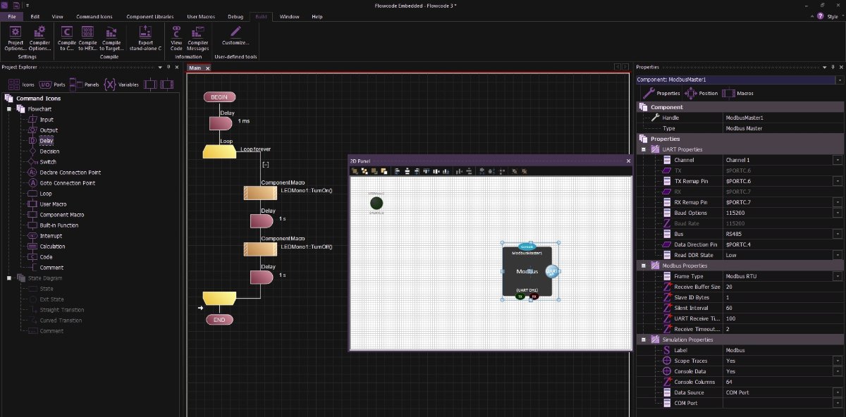

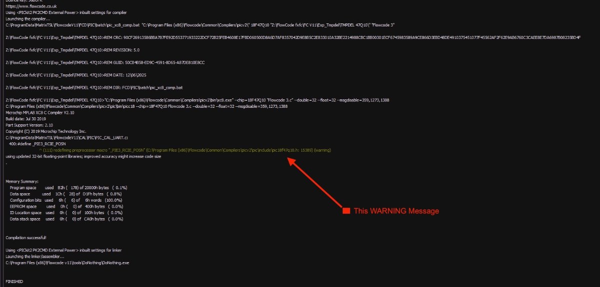

I am getting a warning message while compiling ( please see the picture attached )
is this a bug, OR can it be ignored. Please help.
one observation,
Compiler gives this warning only when i add Modbus / Uart component to the 2D panel
even if i do not add "INITIALIZE" Macro to the Main flowchart code.
with out adding MODBUS / UART component, the compiler compiles without this WARNING.

Thanks for letting us know I beleive the warning is nothing to worry about but I have also managed to fix and remove it now via a library updates related fix. Use the Help -> Library updates menu item to get the latest updates.

Thank you Ben,
Now it compiles without Warning
