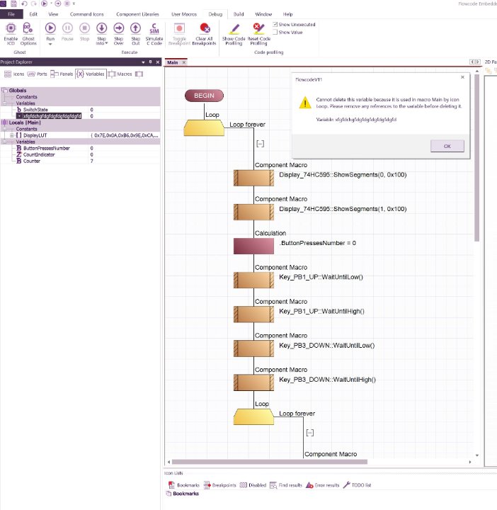

I have a little project I am working on, and I realized I cannot delete the variable marked in the picture below if I am choosing "Loop Forever":
Screenshot 2026-07-13 134859.jpg (65.83 KiB) Viewed 1715 times
I can rename it, but in my FC project, I cannot see it anywhere on a first view.

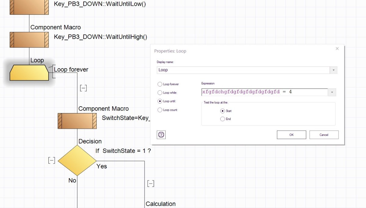

So I started to dig and found it on Properties: Loop, hidden on "Loop until", which was not selected.

Is this a bug that should be reported to Matrix TSL, or is this how FC is expected to work? Below is the project example.

Thanks for the report. As a convenience, Flowcode remembers any expression used in a Loop command. But this is hidden when "Loop Forever" is selected.
This should be fairly easy to fix - I will allow the variable to be deleted if it only shows in hidden/remembered expressions.

For anyone else, if you do face the same issue and don't want to edit the fcfx file within an editor.
Just Right-click on the variable and select List occurrences.
Double click (or right-click and select Show) in the loop icon that appears within Icon Lists window.
You might need to change the loop type to Count, as that is only time you will find a variable.
You find the variable causing the issue (until and update hase fixed it of course).
