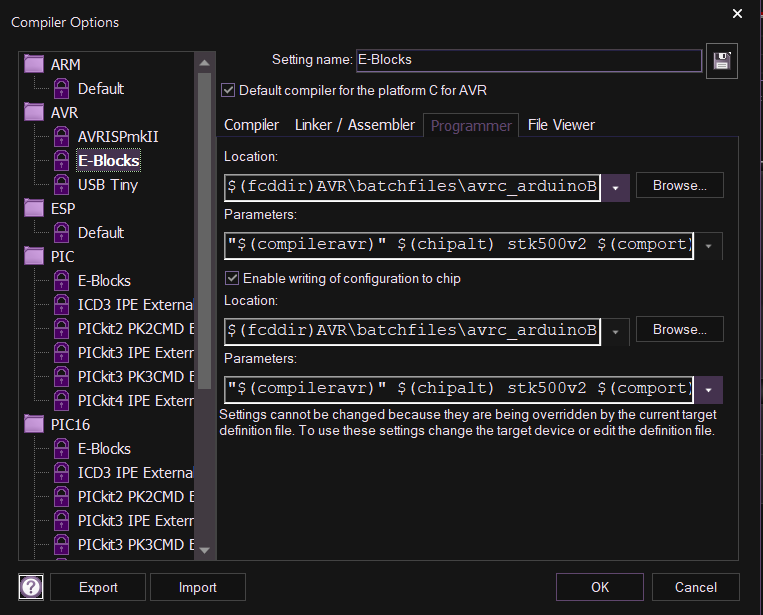

NiamhDaniels
Posts: 3
Joined: Tue Sep 01, 2026 9:51 am
Has thanked: 3 times
Flowcode v11 Re: Problem programming Arduino mega 2560
Post by NiamhDaniels »
Hi Martin,
Very sorry for the delayed response... I've attached a screenshot of the compiler options. I tried the Mega 2560 r3 instead, and this seemed to work (I don't think the board i'm using is genuine- on the front it says mega 2560, when i think it might actually be an r3). Thank you very for your help/looking into it for me :)
Cheers,
Niamh
Screenshot 2026-09-05 133410.png (59.78 KiB) Viewed 759 times

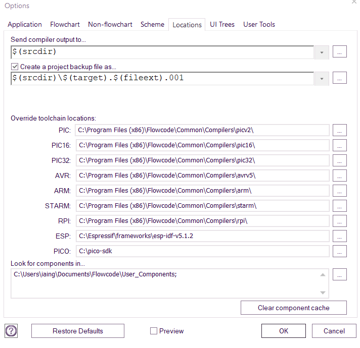

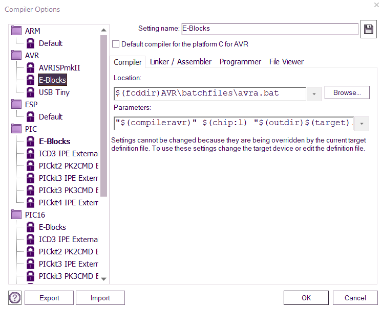

When using a Mega 2560 these are my compiler settings and locations,
Compiler options.png (41.53 KiB) Viewed 754 times
Yours should be similar. However I haven't used a Mega in ages so.......
Posts: 2026
Has thanked: 300 times
Been thanked: 467 times
NiamhDaniels wrote:
Sat Sep 05, 2026 1:38 pm
The programmer options for the Mega 2560 are actually in the FCD (the chip definition file used by Flowcode) and not settable using the compiler options. As the "r3" is working, then I would just use that as the FCDs for the "Mega 2560 R3" is nearly identical to the "Mega 2560" with the exception of the programmer options.
