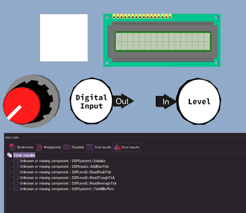

DSP Level Tick is missing?
How to use the DSP Level?
I like to ReadAverage from 200 samples but I miss a Tick.
I tried the sample on the help but the compiler is missing also a tick like me....
App Developer DSP Level Tick is missing

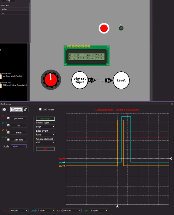

- Posts: 1300
- Has thanked: 246 times
- Been thanked: 258 times
Re: App Developer DSP Level Tick is missing
I tested the Level reset program with the scope.
Every thing look fine but the min Value and max Value is always 0 and 159.
I think there is a problem with the DSP Level component

- Posts: 2334
- Has thanked: 647 times
- Been thanked: 856 times
Hi Stefan,
Many thanks for letting me know. I've made some further optimisations and changes to the level component now and hopefully these will work to solve the problems you're having.
