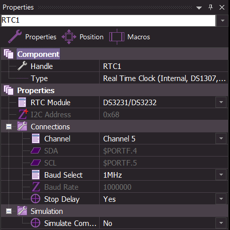

On my board with a PIC32MZ2048EFG100

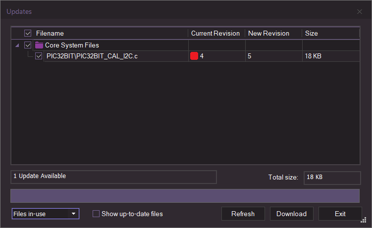

after the update PIC32BIT_CAL_I2C.C from v4 to v5 the RTC is not longer working. The time and day is 000000
If I go back to v4 the real time clock is working again.

Can you have a look, why the update from 4 to 5 for PIC32BIT_CAL_I2C.c is not working correct.
after the update PIC32BIT_CAL_I2C.C from v4 to v5 the RTC component is not longer working. The time and day reading is always 000000

I beleive I have found the source of the problem now and I've released an update via the update system that will hopefully fix the issue.
