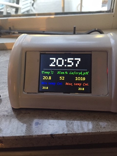

Hereby as promised some examble. The BME280 uden_firkant is a project I made with a BME280, RTC. As on the picture.
Hope this can help you a bit foreward
I spend lot of time with this display Working fine with Flowcode. And it is really fast with ESp32 SPI.
Sorry the picture is "up standing" turn your screen
Good luck
Jorgen
