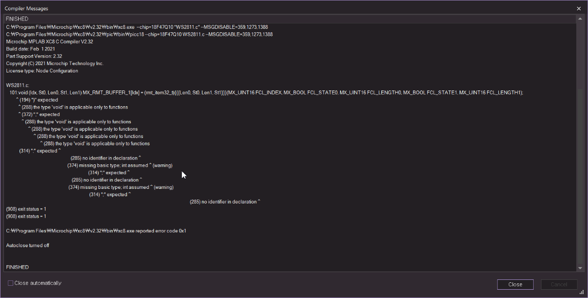

I am trying to design a PCB using the WS2811 library because SK6812 is difficult to program. However, the WS2811 library does not compile. The program used examples from Wiki Help.
Sends a compiler error message.

Re: WS2811, PIC18F47Q10 Compile error!
Many thanks for letting us know, I have now fixed the compilation error.

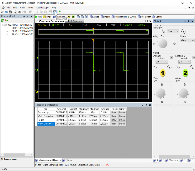

Thank you for your help.
Compile works fine. However, the example program does not work. We will send you the oscilloscope screen for your reference.
I tested the external crystal and internal oscillator on PIC18F26K22, and PIC18F47Q10.
I used WS2812B.
I think the timing isn't right.
Help.
Thank you.
I used WS2812B.

Re: WS2812B, PIC18F47Q10 not work error!(Solved)
I use WS2812b.
I solved it by correcting the time in Custom in the library.
I upload the program I solved.
Be sure to check the timing using an oscilloscope.
SK6812 seems to be difficult for 8-bit PIC. It seems possible on a 16-bit PIC with a higher clock speed.
