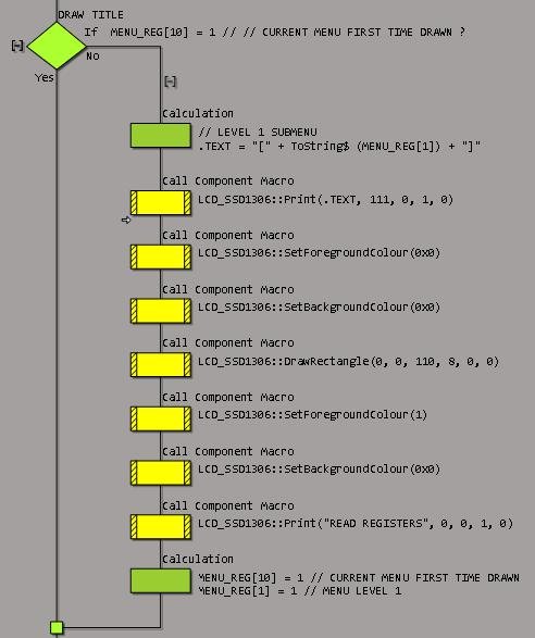

Hi guys,
Maybe I'm doing something wrong here like my logic isn't right... but the emulation of SSD1306 doesn't seem to be working correctly :-(
Little subprogram as follows:

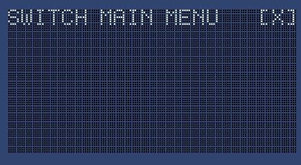

The OLED shows the right image:

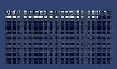

But the FC emulation (2D/3D Panel and Bitmap/Point Cloud modes) isn't right:
Thanks for your help!

Posts: 2332
Has thanked: 647 times
Been thanked: 856 times
Re: SSD1306 Emulation Problem
It looks like the simulated pixel colours are backwards once you set the fg/bg colours, I'll see if we can get that sorted for you.
Edit, should be fixed for you now.
