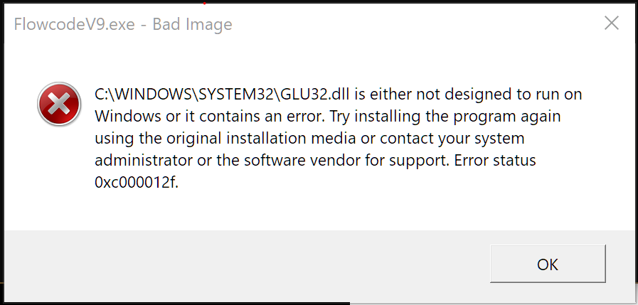

After upgrading to V9 from V6 I can not start Flowcode. Please see attached screen snips for details. I'm running Windows 10 Pro fully updated as of today.

The error you are facing will be more to do with a PC issue rather than Flowcode.
For example, a third-party AV or firewall is preventing Flowcode to access the Windows DLL file.
Or the file itself could be corrupt?
When Flowcode is first installed, I don't believe glu32.dll is a file that is installed.

Searching the internet, it looks like this is either a problem with Windows or with the graphics card drivers. Most suggestions seem to follow this order:
1) Start Windows in Safe Mode
2) Run the Windows System File Checker (SFC) tool
3) Update drivers for your graphics card
Please try this and let us know how you get on.

Thanks Steve-Matrix, I had found the same but wanted to check if there was a known issue before doing the screen time. There were a few more steps to do, but fundamentally your solution worked. I'll post the rest of the steps when I get a chance.
