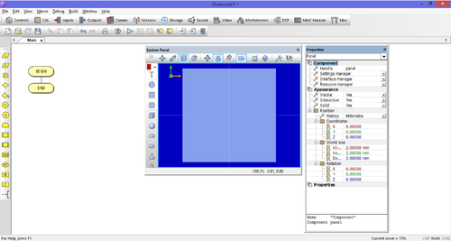

- An empty flowchart window opens, which may contain other items such as a System Panel, Dashboard Panel, Properties Panel etc.
- These can be revealed or hidden using the View menu.
- Set up the flowchart window so that you can see the System Panel and the Properties Panel.
- The flowchart window should resemble the one shown below (depending on the configuration.)
- The System Panel and Properties Panel can be moved by clicking and dragging the title bar at the top of each panel.
