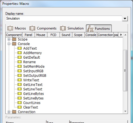

Next we need to assign the handle variable with a value by calling the Simulation API. To do this we add a simulation macro icon to the Main flowchart and double click the item on the flowchart to edit the icon's properties. Inside the icon property window we first need to ensure that the Functions tab is selected and then scroll down to the Console section before clicking the + icon to see all the API calls related to the Console functionality.

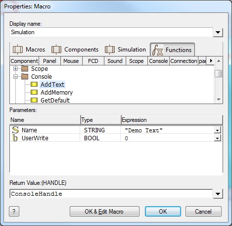

There are two API calls related to creating a new console tab which dictate how the data will appear in the tab by default. The AddText function call creates a new tab as ASCII based text only and the AddMemory function call creates a new tab which defaults to displaying bytes in decimal or hexadecimal format. The return value for both function calls requires a handle type variable, luckily we have already created this above. To access the default tab of the console we can instead call the GetDefault API call and this will populate our handle variable with the specific reference of the default tab.

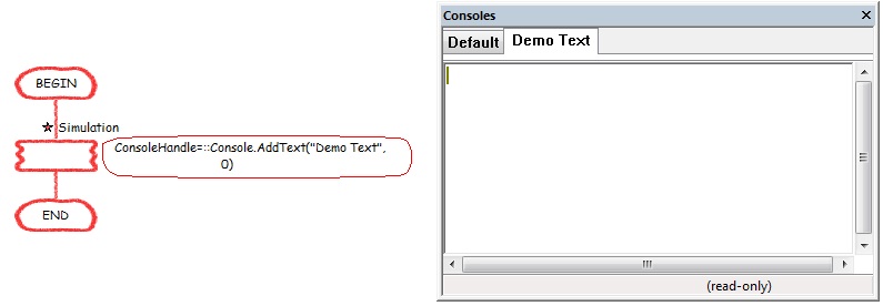

When we run the simulation the new tab will be created on the console window ready for data to be inserted.

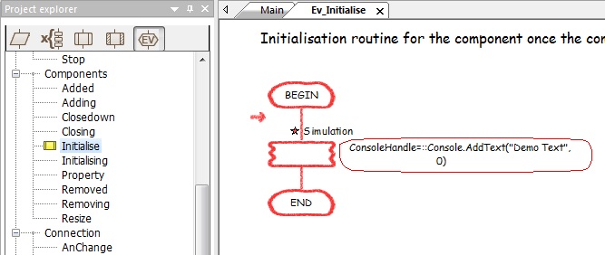

By moving the API call from the Main macro to say the simulation initialise event macro we can create a component which will automatically add our new console tab when the component is added to a program. This is the way that components such as the communications based components add their tabs to the console window.

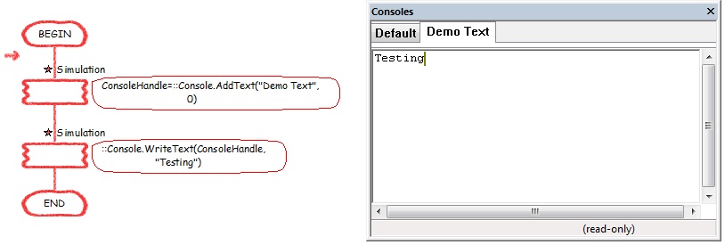

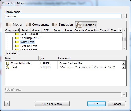

Writing data to the console window can be done at any time from any macro by using the [[Simulation_Macro_Icon_Properties|simulation macro] icon and calling the Console -> WriteText API function.
If we want to display the value of a variable then this can be done by simply passing the variable to the Console -> WriteText API function.

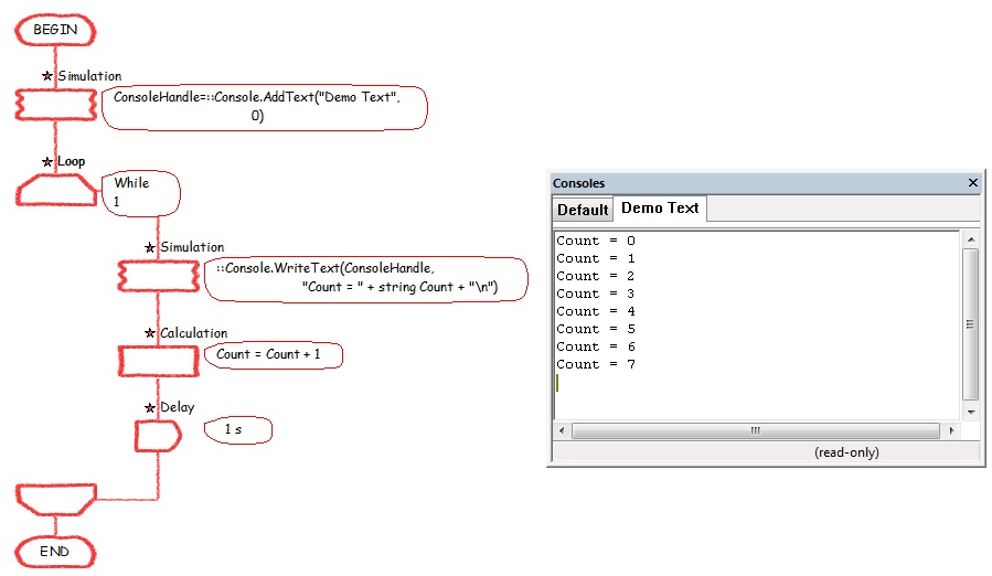

By adding a simple loop, a increment to a variable and a delay we can create a very simple demo to show the console in action as a debugging interface.

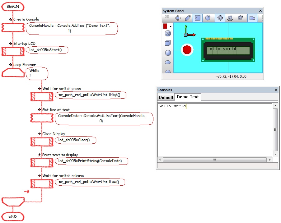

Reading a line of data from the console window can be done at any time from any macro by using the simulation macro icon and calling the Console -> GetLineText API function.
Here is a simple demonstration program that allows a user to type a line of data into the console which is then passed to the LCD component on the panel when the switch is pressed. The ConsoleData reference is a string variable created to hold the value returned from the Console -> GetLineText API function.
If we wanted to we could clear the user data from the console at the end of the loop by using the Console -> SetLineText API function and passing an empty string e.g. "".
