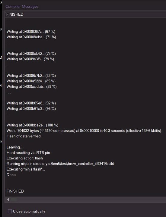

Hi Stefan
Thanks any idea why it wont compile on my machine? I have uninstalled Flowcode reinstalled still not compiling I have also reactivated flowcode licence nothing, this is driving me nuts anyone got any good suggestions on how to sort this.

Re: ESP32 Compiling error
Builds for me too.
I notice this in the error2.txt ...
I suggest that you copy your project to a shorter path and try again.CMake Warning in ../../bootloader_support/CMakeLists.txt:
The object file directory
C:/Users/brian/Dropbox/Designs_and_software/Boards-21-04-14/Boards_In_the_market/PWM_Controller/Test_gLCD_ili9341/Brew_controller_ili9341/build/bootloader/esp-idf/bootloader_support/CMakeFiles/__idf_bootloader_support.dir/
has 222 characters. The maximum full path to an object file is 250
characters (see CMAKE_OBJECT_PATH_MAX). Object file
src/bootloader_common_loader.c.obj
cannot be safely placed under this directory. The build may not work
correctly.
Hi Leigh
Thanks for that it has solved the problem and I have learnt something new, maybe that is why I have had to save my projects 2 or 3 times before it will compile (path to long)
