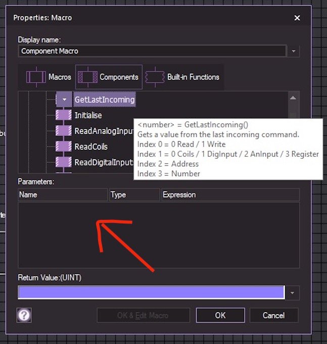

in FC9 App developer / "ModbusSlaveSCADA" component / GetLastIncomming() macro,
i think there should be an INPUT field to enter parameter ( like index 0 / index 1 / index 2 / index 4 )
or am i missing something !!
- S_V

- FC9_ModbusSlaveSCADA_GetLastIncomming.jpg (71.95 KiB) Viewed 12200 times

Hi S_V.
I have added the parameter to the component for FC9
The component won't be pushed onto the update system until next week.
If would you like to test before then, Browse to this location using File Explorer, it's hidden by default so just paste the link into your address bar.
Replace the existing files with the attached file.
If you run any component updates, then the components you added will be overwritten.
Can you let me know if it works for you, please?

Hi Martin,
Thank you so much for the prompt response and the Update.
It is working very well. (I have tested all the functions. in both read/ write).
