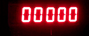

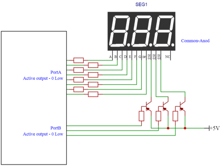

I am reprogramming finished device, so i can not change scheme, to control led display i use component from library Displays: 7segment(single) he use low and high for in and out. But me need both low for in and out :)

Selecting common low and common anode should work as the segments will be low to enable.

Medelec however thx a lot =D I found your solution there with swich off common pin and adding Output pin control =D
Now all work, thanks a lot again =D
