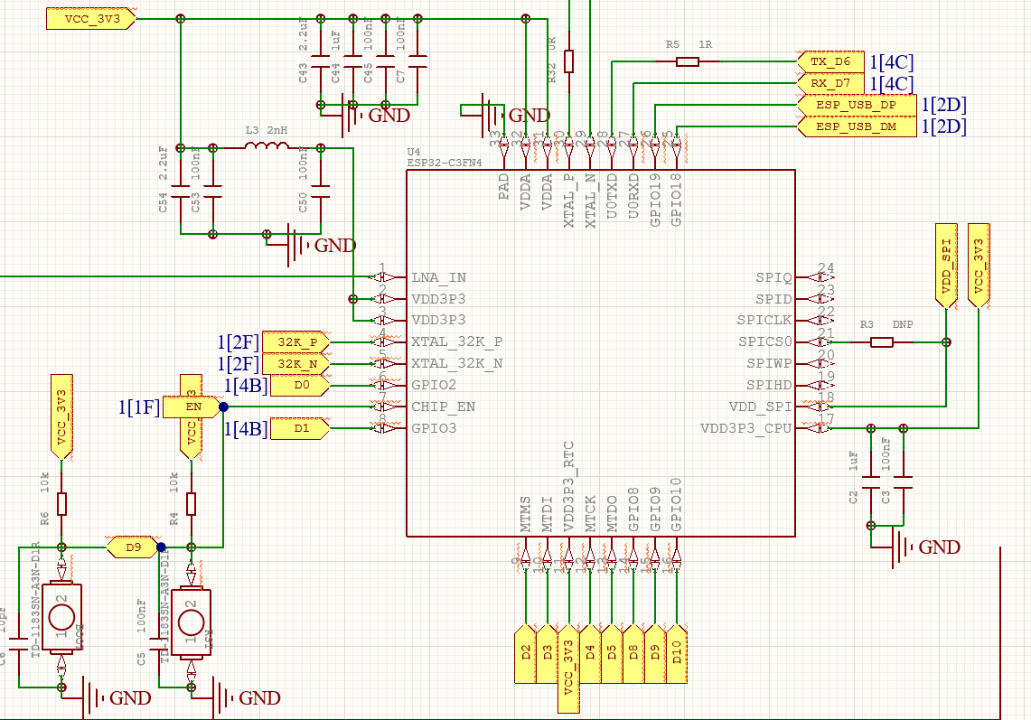

Hi to All
I have the ESP32 C3
I can compile and download to target and it's running
(no press of reset and boot)

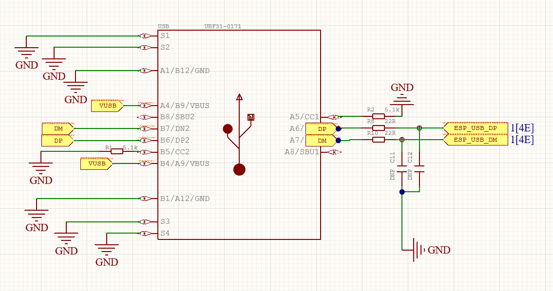

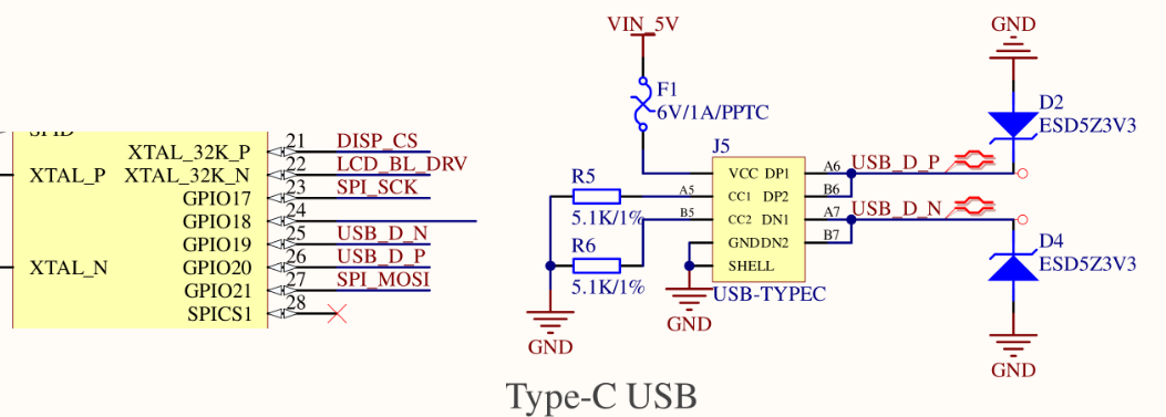

I use the GPIO18 and GPIO19 like the schema for UART/USB
But as soon as I switch on the Uart in FC10 and flash I can not connect anymore the ESP to the computer,
there is no com port anymore also not in the terminalprogram.
For the next flash I need to press reset and boot first
