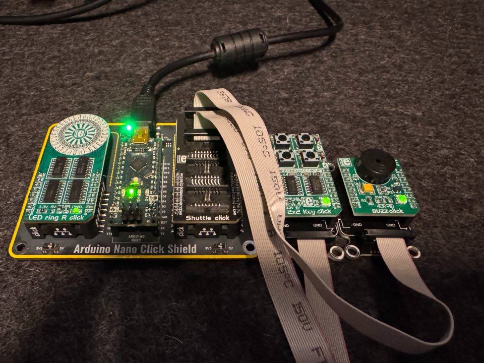

The picture of the whole assembly (I prefer off-the-shelf components to save time, instead of soldering):
The schematic of the 2x2 key Click:

Now, the problem that I have is with the buzzer - it does not work, and it does not want to respond to the 4,000Hz frequency of the simulation. On the PC it works as a simulation (it acts as an active buzzer), but mine is passive, and it has the product code EPT-14A4005P, made by Sanco Electronics.
I want the volume to start lower and, after 5 seconds, increase, motivating the user to stop the timer. How do I do this?
Also, the shift registers are being "corrupted" after a few loops, indicating a sync/timing issue in the code. Would you happen to know where the problem is? Any suggestions on optimizing the flow code are welcome.

You have two buzzers connected to the same pin, a piezo buzzer (EPT-14A4005P) and a simple fixed frequency buzzer. Which one do you intend to use?
I assume the piezo, so delete the other one and all related chart icons.
For the piezo to work you will need to use PWM and set it to roughly 3800Hz. In properties you can set the target frequency and FC will attempt to create the closest match. Remember to set "Apply to defaults" to "yes". FC will then calculate how to create this frequency using a timer.
Now you can use the PWM component macros to enable / disable / set duty cycle (to control the volume) etc.

HI Andreas,
When you say the buzzer does not work - is that at all / or just has a constant volume?
It looks as though you have a buzzer component - and this would connect to the the GPI pin on the buzzer board - this only provides on or off (with no option to control volume). Using the PWM channel (which should be connected to a different pin) - you can alter the tone / volume by setting the PWM frequency and duty cycle - it might take a bit of fiddling to get a harmonious note? At present you don't seem to use this - but setting the appropriate values and then doing Enable should allow this? (and I think you then use one or other to control the buzzer)
I think the loop logic is slightly wrong - at some point the DisplayTime macro is called with -1 (or 255) (at least in simulation) - which will load the shift register with an unknown value.
Iain's beat me to it....
