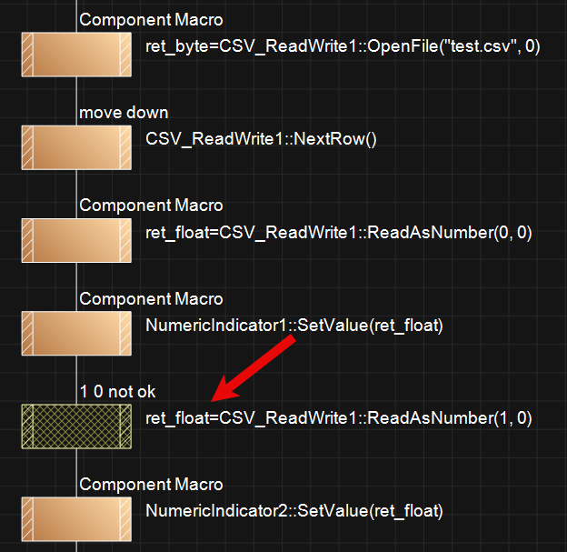

Writing a file works perfectly, if I use delay
reading doesn't go so well
I don't know exactly how to use CSV read/write.
Writing a CSV file works well with the next row command.
But when reading the CSV file, I don't know if I need the command.

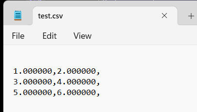

Sometimes when creating and writing the file, I end up with an empty file.
If I already have an empty file, then it works fine when I start the program a second time.
I don't know where I need to wait.
Sometimes I still get a lot of 000000 if I open it with notepad.
One command gets stuck readAsNumber(1,0) but the others work.
Testprogram:

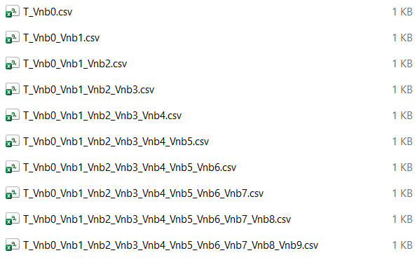

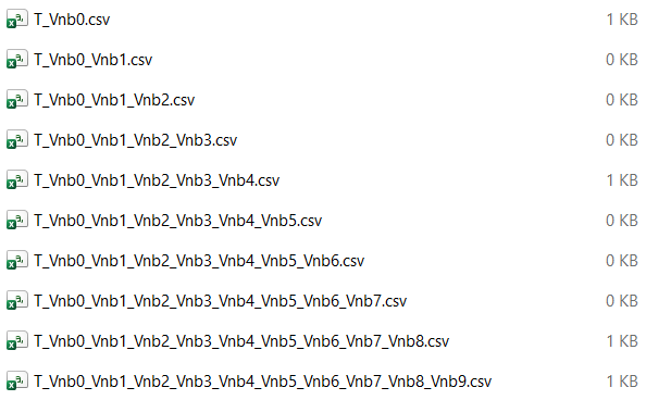

I have written a file that generate 10 files and some with extra long filename.

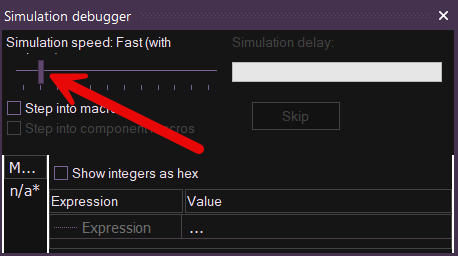

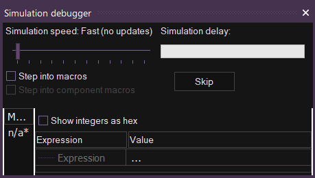

A problem is with the simulation speed.
Can I set it always to full speed?
So I'll start testing “reading CSV into an array.”
The file I need to read has about 12,000 lines.
If this is on second place and the file is small, there is a problem
If this is on first place
it's perfect without a delay and short or long files are ok

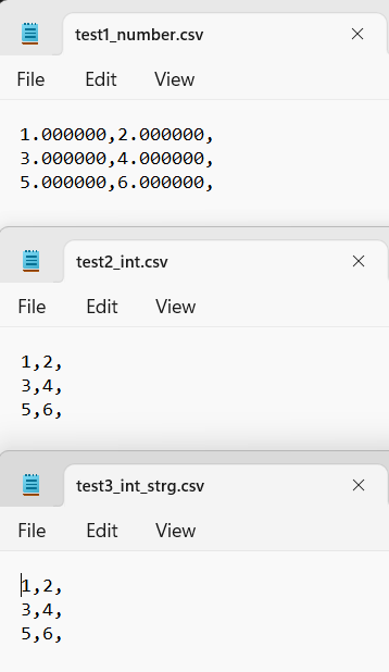

With the lot of zeros it's just write number a problem, write int and write strg is ok.
I think it's because of write float (and not a problem).

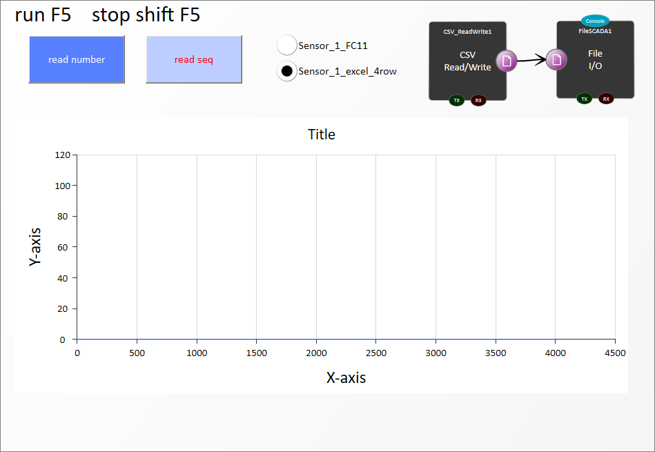

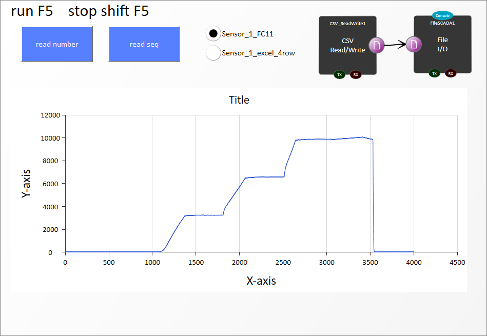

I wrote a program to read a csv file generate from an FC11 App.

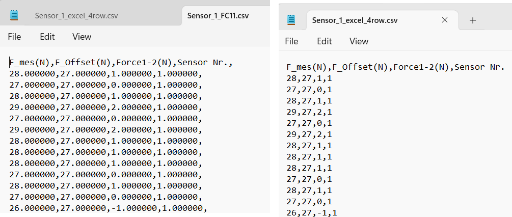

Sensor_1_FC11.csv is the original file

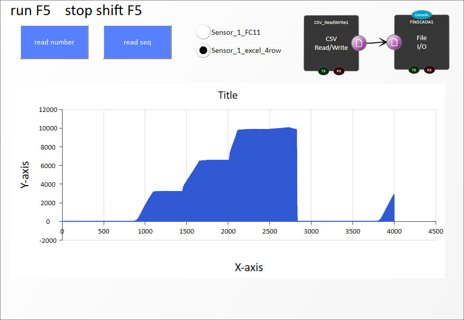

Senser_1_excel_4row.csv is open and save in excel as csv file.
the comma at the end is gone after save.

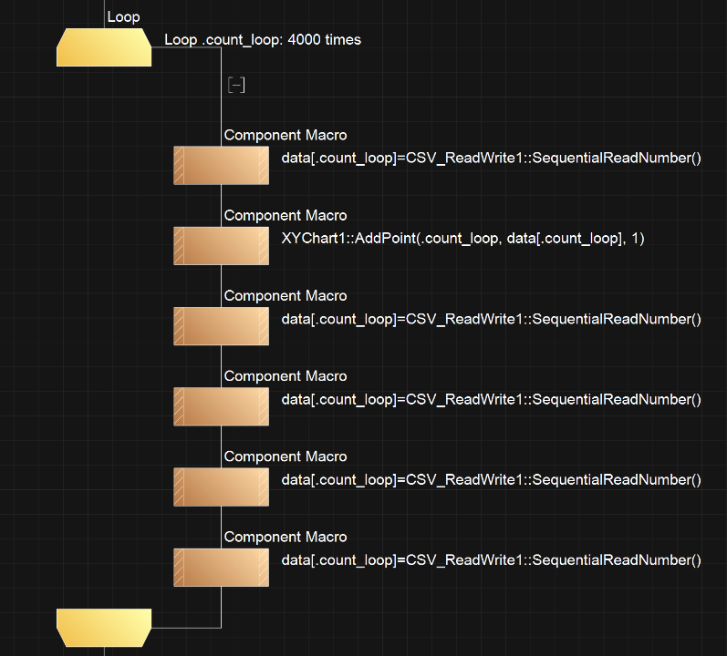

read seq ist working if I add some read but this does not match anymore after excel
read number is not working (anymore)
program
post_csv2_read.fcpcd
(29.91 KiB) Downloaded 152 times
