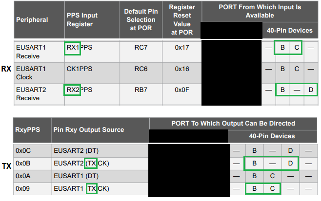

For the UART component, you can only select ports that are designed to be available by the manufacturer.
From the datasheet (I have blanked the 28-pin ports), here are the available ports for channel1 and channel2.
Remap Pins UART Component.png (75.8 KiB) Viewed 3759 times
As you can see, only B and C are avaiable for Channel2
If you want to use port C for both channels, then instead of using channel2 you could use the UART software (Timer) component.
