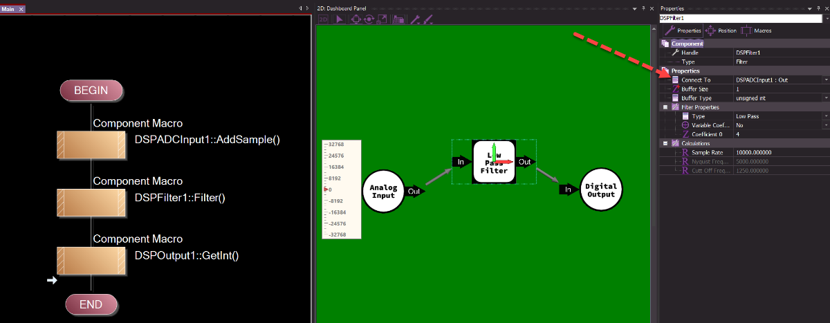

how to apply this filter on ADC should it work??? who knows show an example on atmega 328p

You need to connect and use a filter command.
My example is not an Atmega but it shows you how it should work.
It is possible to use the AD directly as a DSP input, but I always use the DSP input
example:
FC9_Post_DSP_Filter.fcfx
(11.48 KiB) Downloaded 413 times

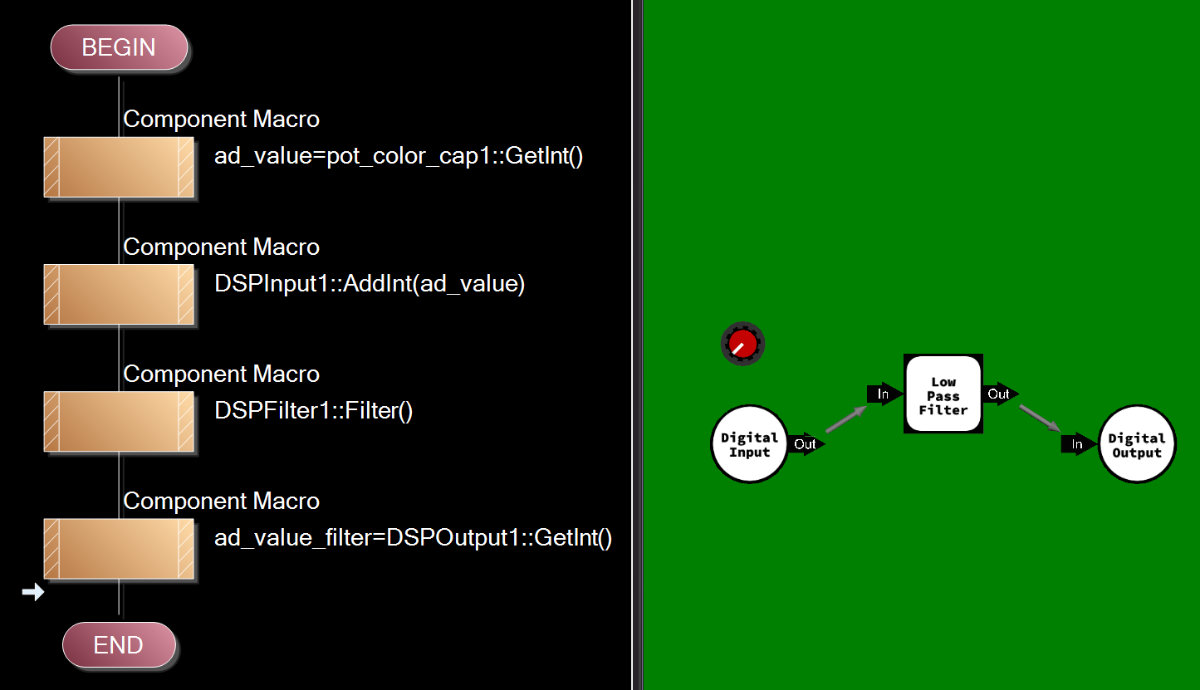

AD directly as a DSP input:
But I always use the DSP input:
