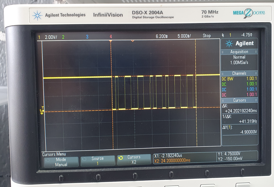

Started at square one: make sure that the IR detector actually receives and outputs a signal.
See attached, looks OK, no? RC5. So that's what goes into pin C2 of the setup in the previous post.
But the display only shows three zero's .
Any ideas, anyone?
Jan
Any ideas, anyone?
Jan
- RC5.PNG (1.12 MiB) Viewed 17071 times

I had a quick try getting the RC5 component to work (wouldn't compile for Arduino or ESP32 - but 3rd time lucky with a PIC). I couldn't read any remote I tried, and I tried a 'basic' one from an Elegoo kit, several TV remotes etc, so I tried using the Arduino IDE and installed the IRRemote library.
After a bit of 'fiddling' - I got this to work and all the the remotes I had tried seemed to use NEC format commands. Having said which - the wave form from the IR sensor doesn't look like yours above.
Are you sure it's RC5? - the Arduino lib is quite an easy way to test this.
I have a 'OneForAll' remote - which I can try with many different TV encodings and hopefully one will be RC5 (Philips?) - so will have an experiment with that too.

I am fairly sure I have (several) RC5 remotes and eyeball-decoding the previously shows scope screen shot shows what I think is RC5 code.
