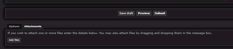

Hi When I click the 'add image button' I get this:
There is no 'add file' button that I can see
Posts: 1961
Has thanked: 292 times
Been thanked: 458 times
Re: Potentiometer not acting as analogue input
It will be here once you have clicked on the button to reply:
2022-10-19 17_12_28-Flowcode Support Board - Post a reply.png (13.35 KiB) Viewed 4142 times

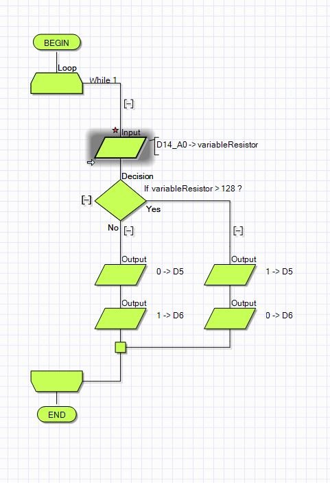

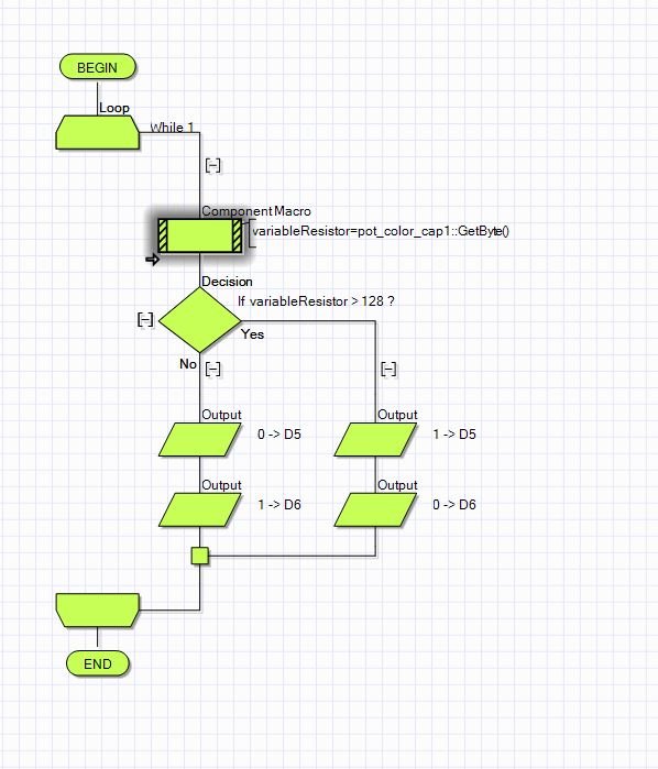

Hiya
See the attachments button now :D
Two files are there - neither of which works on Arduino although the simulation works fine

Posts: 2325
Has thanked: 724 times
Been thanked: 783 times
Please, always post your project file that ends with .fcfx as from the images we can't see your component property settings that can have an effect on your hardware.
