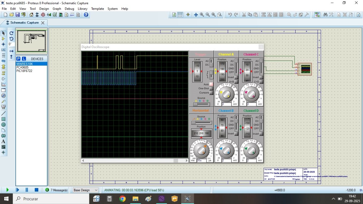

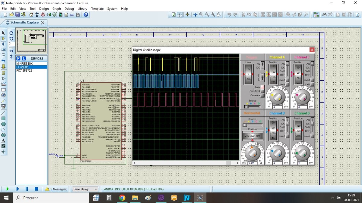

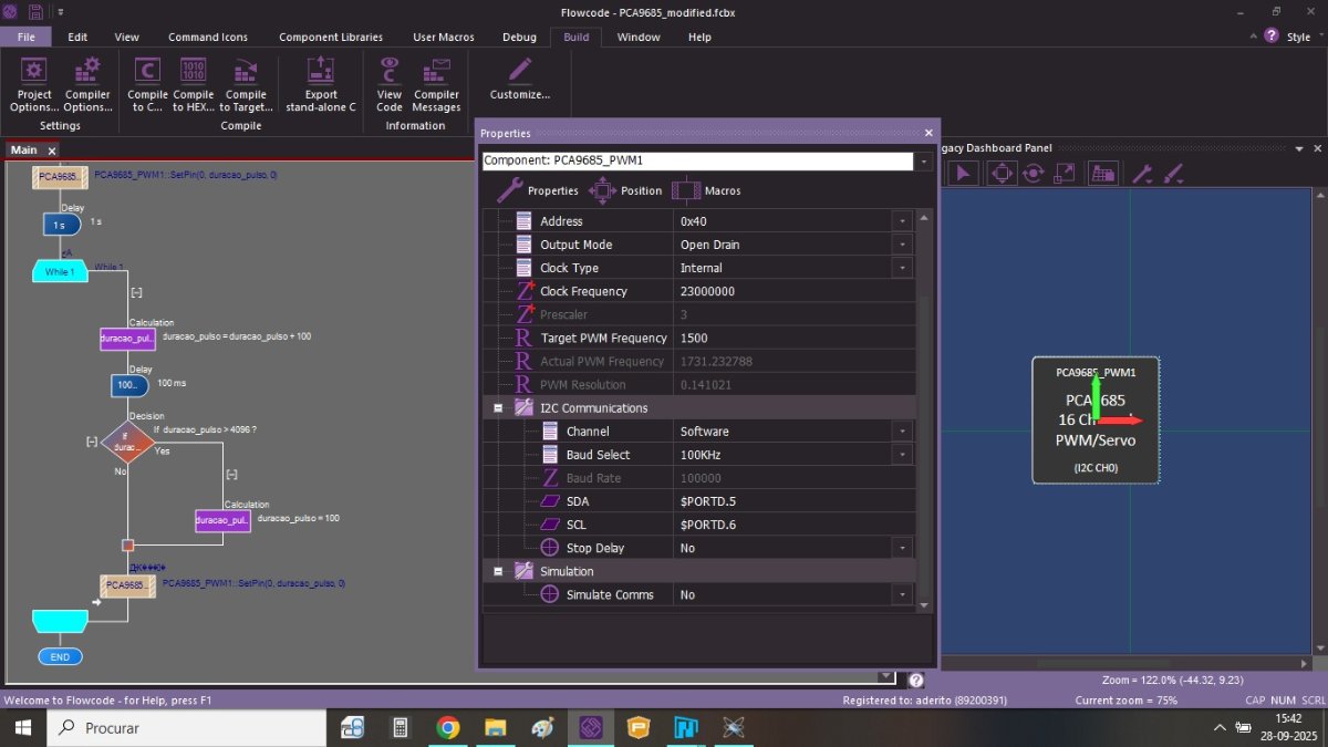

here are the related files
teste proteus.jpg (213.56 KiB) Viewed 7772 times
PCA9685.fcfx
(11.8 KiB) Downloaded 339 times
flowcode configuracao.jpg (96.66 KiB) Viewed 7772 times

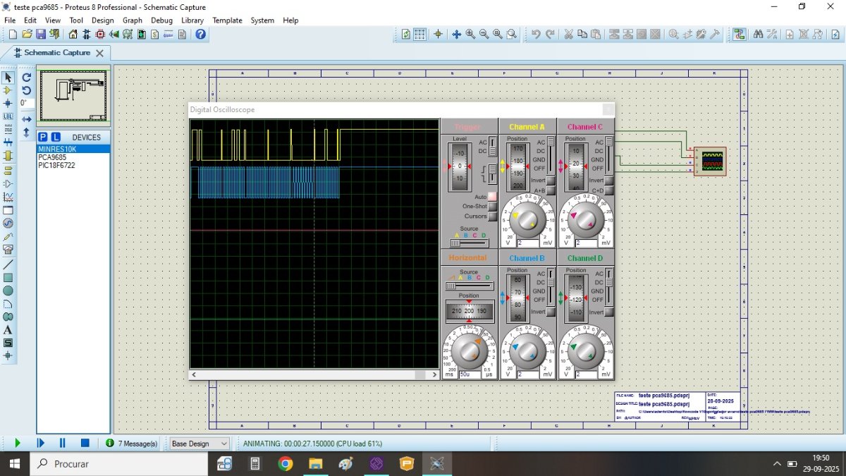

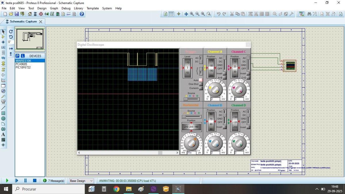

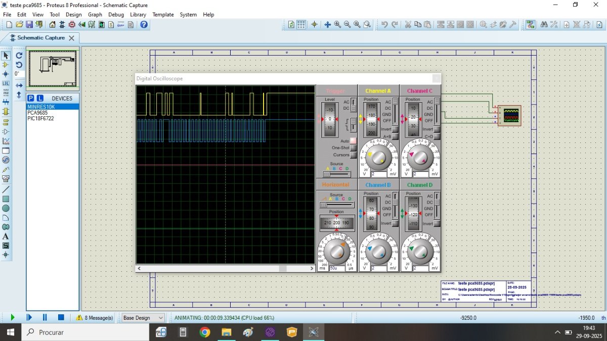

Post by aderito »
As promised, I will post 6 screenshots. The first 3 refer to the configuration in "software" mode and the next 3 in "channel 1" mode.
teste proteus channel 1_3.jpg (182.78 KiB) Viewed 7712 times
teste proteus channel 1_2.jpg (183.05 KiB) Viewed 7712 times
teste proteus channel 1_1.jpg (181.35 KiB) Viewed 7712 times
aderito
Posts: 37
Joined: Sun Jan 29, 2023 12:49 pm
Location: portugal
Has thanked: 19 times
Been thanked: 2 times
Re: bug with pca9685
Post by aderito »
each capture represents the three configuration steps plus the loop

this is the test program
PCA9685.fcfx
(11.72 KiB) Downloaded 347 times
