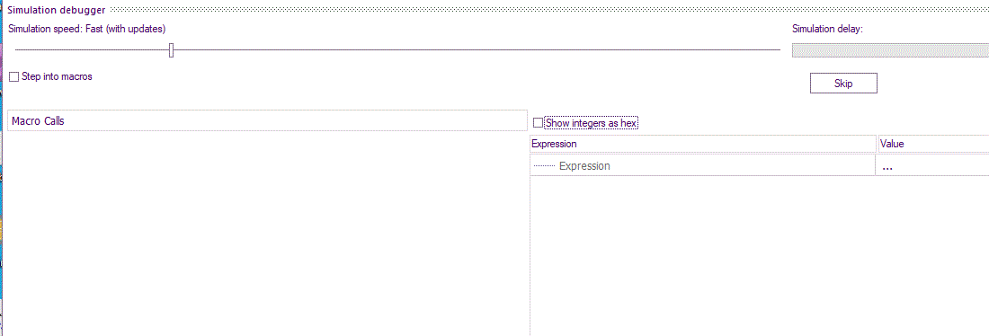

I tried all your ideas quite a few times but unfortunately still does still not work in ICD
After pushing start or step into there is a pause and then the simulation debugger screen comes up copy enclosed
But everything then appears to be frozen ie nothing works
Pushing the reset button on the BL0032 is the only way allows me to get back into FC9
Looks like it could stuck in a loop somewhere
Also pushing the reset button after compiling to target has no improvement and then pushing go or step still does not work
Also adding a break point has no affect
David

I've been unable to replicate this issue here, although I did encounter a similar issue when a breakpoint was set within the project loop.
This time, pressing 'go' ran the project but the breakpoint was never hit and the ICD acted like it had finished. Following Ben's suggestion, I found that first pressing 'step in' and then waiting maybe 6 seconds until the green icon marker is shown on the first icon allows the ICD to run correctly.
Also, what happens when the simulation speed is set to 'fast (no updates)'? You will need to step into execution first and then adjust the sim speed.

Hi Steve / Ben
Note whilst i get the debugger window i do not get the green box around any program components
I also tried running the debugger at full speed but still no difference
I have also included the compilation messages file and c code file in case there is anything in there of interest
David
David
