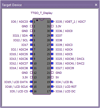

Chip View
The pins of the selected target microcontroller is displayed in this window.
When the flowchart is being simulated, the state of the microcontroller I/O ports are shown on the microcontroller as red and grey for high and low outputs respectively.
