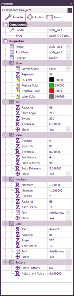

Component properties controls how the component functions as well as how it is displayed and where it is situated on 2D Panels or the 3D System Panel.
To bring up a components attributes and properties you can right click on a selected component and click 'Properties' from the context menu.
This will bring up the 'Properties Panel' (as displayed to the right), there you can see the components attributes and properties.
If the Properties Panel is already being displayed simply click on a component to bring up it's properties on the panel.
The properties for the component can be edited in the Properties Panel by simply clicking the property value and/or typing in a value, this depends on the component and the property, many components have similar properties and some serve a completely different purpose because of the radical difference between some components. File:Gen_Scale_Arc_Component_Properties_01.png|right|frameless
There are many different properties used in a range of different components, take the Scale Arc component for example, this offers a vast range of properties to customize the appearance and function of the component.
The Scale Arc component properties allow you to change the colour of the negative and positive markings, labels and backgrounds as well as the resolution and shape of the canvas. There are many other properties available to change to customize the component to suit your desired purpose, you can change nearly every aspect of the Scale Arc just by changing the properties of the component.
The broad range of properties makes the component an excellent component base got creating or further improving existing components by adding the component or tying in its functionality with different components. By having so many different component properties readily available from the get go, it allows you to create create a robust and complex component which can be suitable for many different purposes and use in different fields entirely due to the wide range of functionality available.
A lot of components rely on other components, and some components are only used to support other components, such components as the Button helper and switch base, are used to create and enhance components to add extra functionality which may even require and rely on these components to function.
Other components such as the LCD and 7-Segment Displays require components which can alter a variable to input a value for the component to display, these components are not as reliant as others and can be changed by altering the variables whilst running the flowchart, rather than using other components to change the variable value.

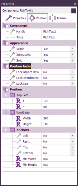

Visible, Interactive and Solid
There are a number of Flags available to determine how the component or object will react in the system.
Visible - Determines if the component or object can be seen.
Interactive - Determines if the component or object can be used to collect mouse events such as clicks or drags.
Solid - Determines if the component or object will work with the panel collision system.
Position Locks
There are an additional number of position lock Flags available to determine how the component or object will react in the system.
The Locks are only available when the Panel root object is selected allowing you to apply the rule to all the components and objects within your current project. If you then export the project as a component then the component will be initialised with the lock settings.
Aspect Ratio - Determines if the component or object can be none uniformly scaled.
Coordinates - Determines if the component or object can be moved around on the panel.
Size - Determines if the component or object can be scaled or re-sized.
Rotation - Determines if the component or object can be rotated on the panel.
Coordinates world and local
For the ability to display the coordinate properties in respect to local space or world space you can click on the coordinates heading to get a menu.
Scales world size, local size and local scale
For the ability to display the scale properties in respect to world size, local size or local scale you can click on the scale heading to get a menu.
Anchors
2D panel objects can be anchored to any edge of the panel, allowing objects to move when the panel is resized. Anchoring an object to opposite edges (e.g. both left and right) will cause the component to automatically resize when the panel is resized. The Min Width and Min Height properties prevent a resized component from becoming too small.
If a 2D panel contains a single component, that component can be made to fill the whole panel and resize appropriately. To do this, set Fit component to "Yes" in the properties of that 2D panel.
